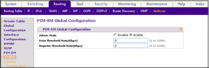

  9. Enable PIM-SM globally.
    1. Select Routing > Multicast > PIM > Global Configuration.
      A screen similar to the following displays.
    2. For PIM Protocol Type, select the PIM-SM radio button.
    3. For Admin Mode, select the Enable radio button.
    4. Click Apply.

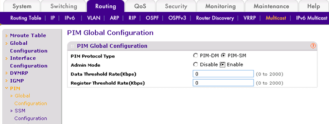

  7. Enable PIM-SM globally.
    4. Click Apply.

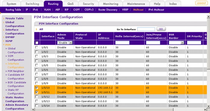

  8. Enable PIM-SM on interfaces 1/0/10 and 1/0/11.
    1. Select Routing > Multicast > PIM > Interface Configuration.
    2. Scroll down and select the Interface 1/0/10 and 1/0/11 check boxes.
    3. In the Admin Mode field, select Enable.
    4. Click Apply to save the settings.

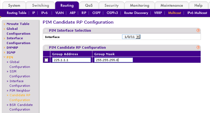

  9. Set up the candidate RP configuration.
    1. Select Routing > Multicast > PIM > Candidate RP Configuration.
    2. In the Interface list, select 1/0/11.
    3. In the Group IP field, enter 225.1.1.1.
    4. In the Group Mask field, enter 255.255.255.0.
    5. Click Add.

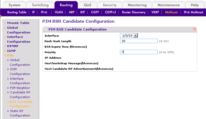

  10. Set up the BSR candidate configuration.
    1. Select Routing > Multicast > PIM > BSR Candidate Configuration.
    2. In the Interface list, select the 1/0/10.
    3. In the Hash Mask Length field, enter 30.
    4. In the Priority field, enter 7.
    5. Click Apply.
    4. Click Apply.

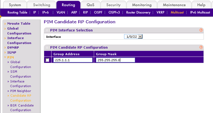

  9. Candidate RP Configuration.
    2. In the Interface list, welect 1/0/22.
    5. Click Add.

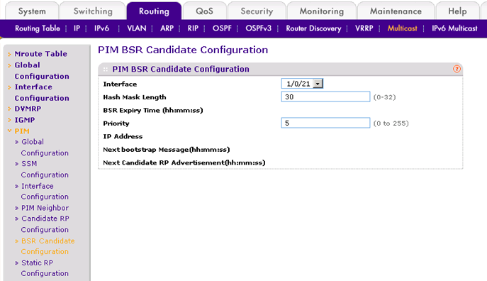

  10. BSR Candidate Configuration.
    2. In the Interface list, select the 1/0/21.
    4. In the Priority field, enter 5.
    5. Click Apply.
    4. Click Apply.
  10. Enable PIM-SM on interfaces 1/0/21, 1/0/22, and 1/0/24.
    2. Scroll down and select the Interface 1/0/21, 1/0/22, and 1/0/24 check boxes.
  11. Set up Candidate RP configuration.
    2. In the Interface list, select 1/0/22.
    5. Click Add.
