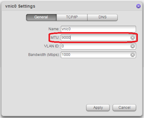

  7. Click the Properties item. The example is changing the virtual interface vnic0.
    The settings windows for that vnic appears.
  8. Increase the MTU to the required value
    Typically, the vnic MTU must be set to the same value as the physical interface MTU.
  9. Press the Apply button.
