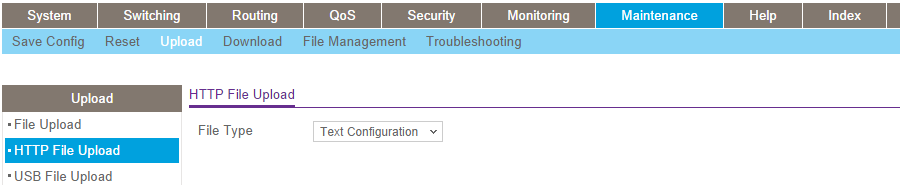

  1. Save the current configuration data. Normally, the firmware will preserve the original configuration in the switch. However, because this is a major firmware upgrade, you may want to save a copy of current running configuration, just in case something goes wrong during the upgrade. To do so, go to "Maintenance -> Upload" page, and select Text Configuration option and click the Apply button to save the configuration file.

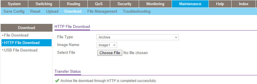

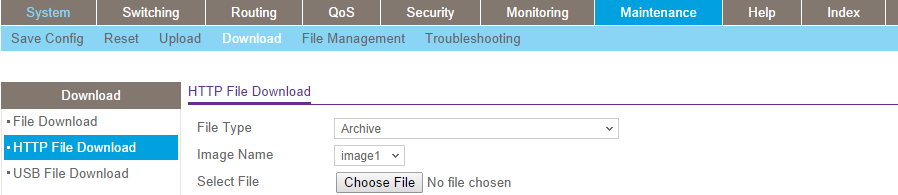

  4. To use HTTP method, go to the following web GUI page (Maintenance -> Download -> HTTP File Download), select the location of the new firmware via the Choose File button, and click the Apply button to start firmware upgrade. The upgrade will take about 12 minutes. Do not power cycle the switch before the process is complete.
    After the Apply button is clicked, the file transfer will start, and followed by writing the new image to the Flash memory. Do not power cycle or reboot the switch before the process is complete, and the success message will show up as below.
    After the successful completion the upgrade, proceed to step #8 to restart the switch.

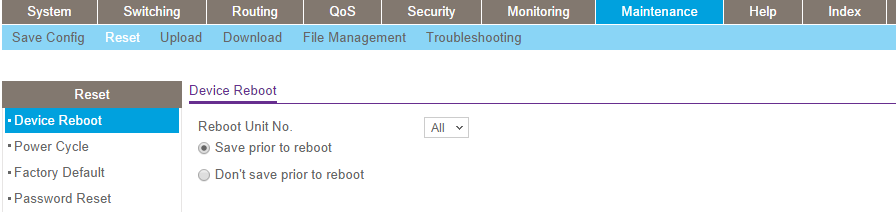

  8. To use GUI to restart the switch, go to web page "Maintenance -> Reset" page, Device Reboot table.
    Make sure that "All" is selected in "Reboot Unit No" drop down menu box. If it is shown with some other value like "1", then only unit 1 in the stack will be rebooted, and this may result in stack failure after the stack is rebooted. You may select "Save prior to reboot" option if you feel there are changes that may not have being saved. Click the Apply button to start the reboot process.
