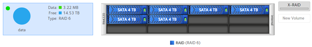

To configure a hot spare disk on a ReadyNAS OS6 device:

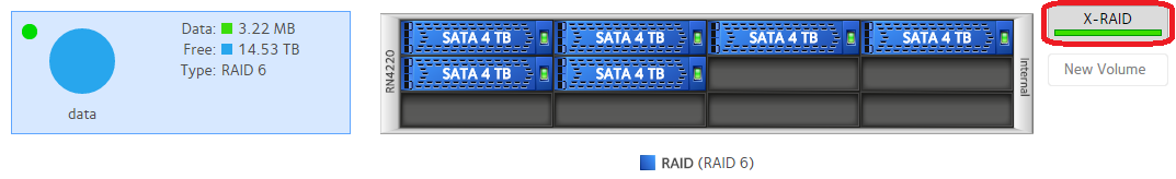

 1.  To disable X-RAID, click the X_RAID button marked in red.

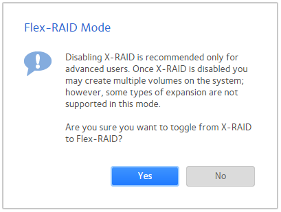

 2.  When prompted with the pop-up below, click the Yes button.
The green light under the X-RAID button turns grey. This change indicates that X-RAID is disabled and Flex-RAID is enabled.
