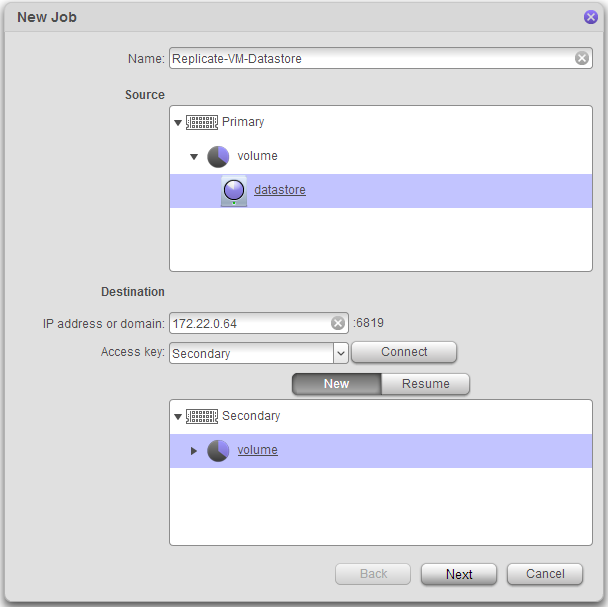

  1. On the primary ReadyDATA unit, go to Replicate> Jobs and click the New Job button.
  2. Give the job a name.
  3. Select the source dataset.
  4. Enter the IP addressof the secondary system.
  5. Select the corresponding certificate entry.
  6. Click the Connect button.
  7. Choose the volume on the secondary unit on which the dataset is to be replicated.

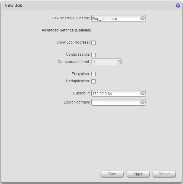

  8. Complete the remaining job configuration windows as shown in the example below.

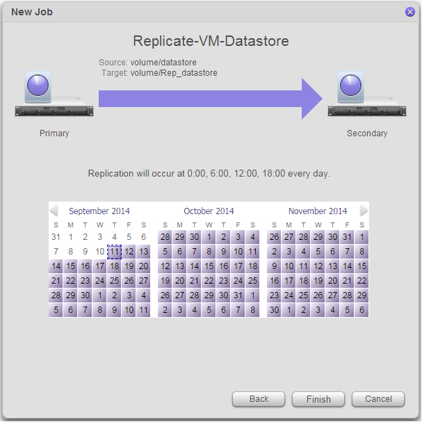

  9. Click the Finish button.

In this example, we use mostly the default options.
  • The compression, encryption, and deduplication options are applied onlyduring the data transfer.
  • When the data is stored on the destination system, it has the same characteristics as the source dataset.

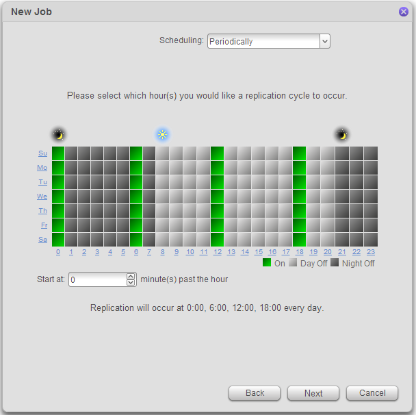

  • For the schedule, we selected periodically and set the job to run every 6 hours.

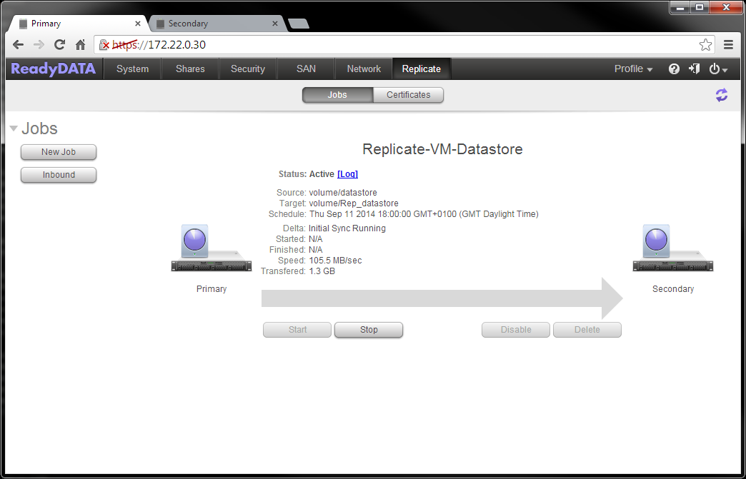

When the first 6 hour interval arrives,the job begins doing the initial synchronization as shown below.
Depending on the size of the source dataset and the bandwidth of the network connecting the two ReadyDATA units, this initial synchronization might take a long time. You can seed the job before doing this initial synchronization. For more information, see section Seed or Reseed Replication in the ReadyDATA software manual or look at this article.
After the initial synchronization is complete, when the next 6 hour interval arrives, Replicate will transfer the incremental changes from the primary system to the secondary.
The primary ReadyDATA unit is now protected through Replication to the secondary ReadyDATA unit.
