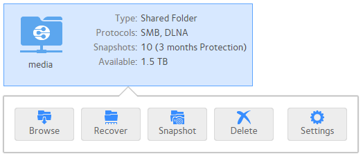

Next, go to the Shares page. Click on the share while will be used to store the music and video files and press Settings:
Go to Network Access, then iTunes and enable iTunes for the share by setting the toggle button to On. Then press Apply.

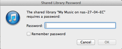

    Click on Music and in the pop-up window under Shared Libraries select your NAS.
    If Password has been configured on iTunes service you will need to enter the password at this time
    Now you will see the content that is stored on the NAS and it can be played through iTunes

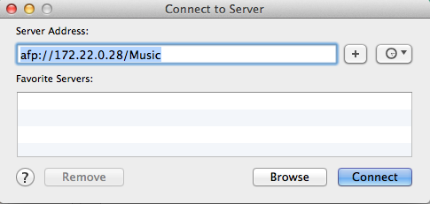

    To begin, mount a share to the Folder on the NAS where the iTunes library will reside. To do this:
    Open Finder.
    Click Go.
    Click Connect to Server.
    Enter the protocol, IP address or hostname of the NAS, and path to the folder where the video and music files reside.
    It will be useful to make a permanent mapping to this location.

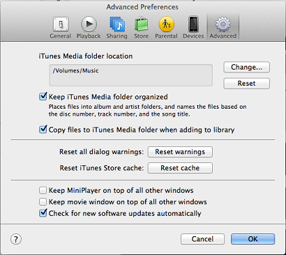

    Launch iTunes application.
    Click iTunes - Preferences.
    In the Preferences window, click on Advanced.
    Under iTunes Media Folder Location, click change and browse to the mount point created earlier.
    Click OK.
    Click Scan for Media.
    Now the content stored on the Directory you have chosen, for the iTunes library will appear.
