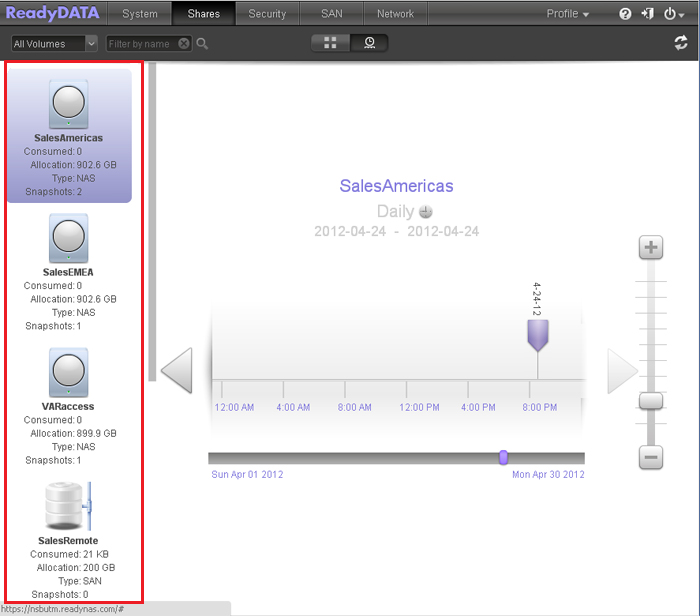

The shares and LUNs are displayed on the left of the screen.
3. Select the share or LUN whose snapshots you want to view.

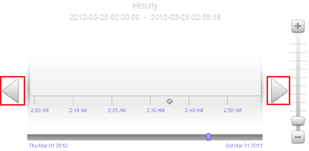

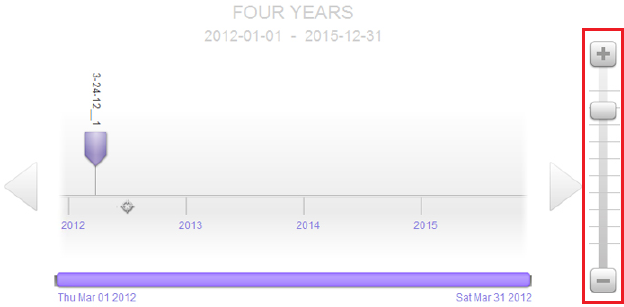

Adjust the vertical slider on the right of the timeline as needed. To expand the timeline to years, click the + button. To limit the timeline to hours, click the - button.
Use the arrow buttons to the left and right of the timeline as needed to move forward in time (right arrow button) or back in time (left arrow button) in time.
Note: The following screenshot does not include a snapshot because it was not taken in the 2:00 AM-2:50 AM timespan.
