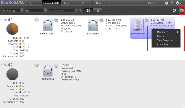

To view and change the properties of a LUN:
1. Select Shares.
2. Click the Data Set button (with four cubes, Image).
The Shares screen displays (see the figure in Step 4).
3. Select the LUN that you want to explore by clicking it.
The color of the LUN turns purple.
4. Right-click the LUN.
A pop-up menu displays:
5. Select Properties.
The Properties pane for the selected LUN displays at the right of the screen:
Note: You can also use a shortcut to display the Properties pane of a LUN. Click the screen Expand button (Image) on the top right of the screen to display the Properties pane (see the red oval on the top right of the previous figure). Click the same button (which now appears as a reversed arrow Image) again to hide the Properties pane.
6. Change the settings as explained in the following table. Click the flag button (Image) to save any changes in a field or drop-down list.
