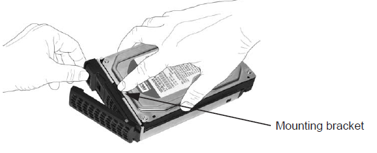

5. While holding the disk tray release latch, pull out the mounting bracket and slide the bracket down the tray.
You do not need to fully remove the mounting bracket from the disk tray.

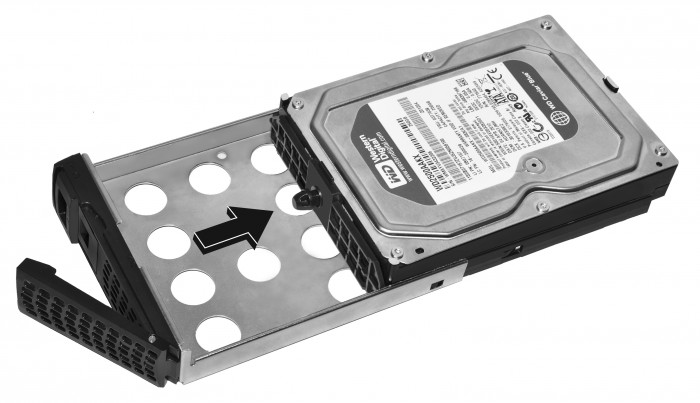

6. Remove the old HDD from the mounting bracket.
7. Attach the new HDD to the mounting bracket.
Make sure that the HDD mounting holes are aligned with the bracket's mounting posts, and that the HDD connectors face the interior of the disk tray.
8. Push the mounting bracket with the hard disk drive back into the disk tray.

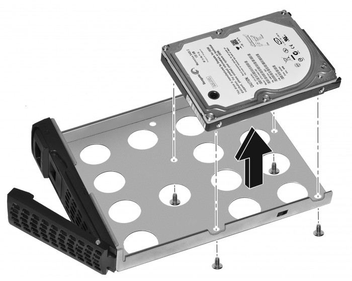

3. Pull out the disk tray and replace the 2.5-inch HDD or SSD:
a. Remove the screws and the old 2.5-inch HDD or SSD.
b. Place the new 2.5-inch HDD or SSD in the disk tray.
c. Secure the HDD or SSD to the disk tray using the screws.
Make sure that the disk connectors face the interior of the disk tray.
