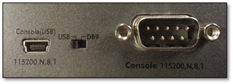

You will need a DB9 cable or a “mini-B” type USB cable.
If you use a mini-B USB you will need the “USB Console Driver” available on this site.
You will need a serial client like putty.
  • Turn OFF the switch.
Choose the correct position for the USB/DB9 selector based on the cable type you are using.
