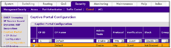

- Select Security > Control > Captive Portal > CP Configuration.
A screen similar to the following displays.
- Under Captive Portal Configuration, scroll down and select the CP 1 check box.
Now CP 1 appears in the CP ID field at the top.
- In the Block field, select Enable.
- Click Apply to save the settings.
