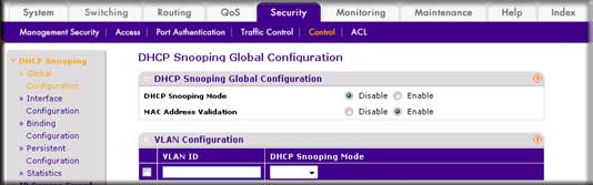

- cEnable DHCP snooping globally.
- Select Security > Control > DHCP Snooping Global Configuration.
A screen similar to the following displays.
- For DHCP Snooping Mode, select the Enable radio button.
- Click Apply.
- Enable DHCP snooping in a VLAN.
- In the VLAN ID field, enter 1.
- In the the DHCP Snooping Mode field, select Enable.

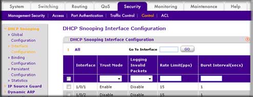

- Configure the port through which the DHCP server is reached as trusted.
Here interface 1/0/1 is trusted.
- Select Security > Control > DHCP Snooping Interface Configuration.
- Select the check box for Interface 1/0/1.
- For Interface 1/0/1, set the Trust Mode as Enable.
- Click Apply. A screen similar to the following displays.

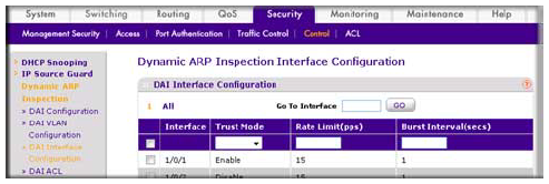

- Configure port 1/0/1 as trusted.
- Select Security > Control > Dynamic ARP Inspection > DAI Interface Configuration.
- Select the Interface 1/0/1 check box.
- For the Trust Mode, select Enable.
- Click Apply.
