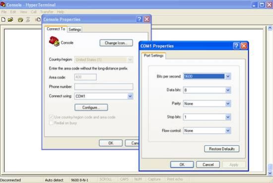

  4. Start the terminal software with the settings: baud rate-9600 bps, data bit-8, parity-none, stop bit-1, flow control-none . The firmware image to be loaded onto the switch should be stored on that computer. It is the same firmware image file being used in firmware upgrade.

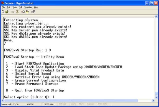

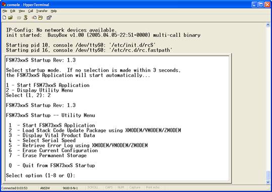

  5. Power the switch on. When the console message display the two menu options (1. Start Application. 2. Display Utility Menu), enter “2” to start the Utility Menu.

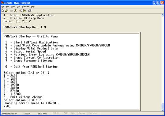

  6. Increase the speed of the switch’s console connection. This reduces the time it takes to load software using the switch’s console port.
  7. After the speed of the console port has been changed, the terminal software has to be reconfigured with the increased speed.

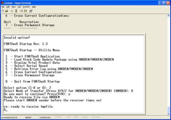

  8. From the utility menu, select the option to load software using XMODEM.

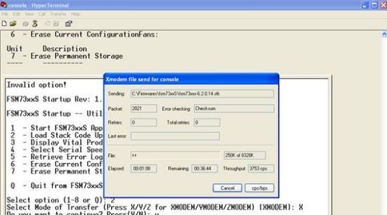

  9. From the terminal software, start to transfer the firmware image file using XMODEM. If using Microsoft Hyper Terminal, go to menu Transfer->Send File, browse to the location where the firmware image file is saved and select XMODEM as the protocol, then click the Send button.
  10. The firmware image will start the transfer to the switch. It will take from 30 minutes to more than an hour for the file to be completely transmitted depending on the console port speed. DO NOT power cycle the switch or interrupt the download from this point on until the download is completed.
  11. After the file transfer is complete, the switch will start extracting various components into the FLASH. You can see the status in the console messages. After the download process is complete, you will be returned to the Utility Menu. Enter “1” to start application. The switch will boot up fully to the user name prompt.
