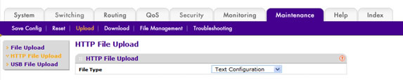

  1. Save the current configuration data. Normally the firmware will preserve the original configuration in the switch, however, just in case something went wrong during the upgrade, you may want o save a copy of current running configuration. To do so, go to 'Maintenance->Upload' page, and select Text Configuration option and click Apply button to save the configuration file.

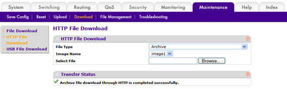

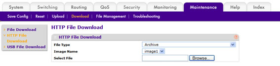

  3. To use HTTP method, go to the following web GUI page, and select the location of the new firmware via browse button, then click Apply button to start firmware upgrade. The upgrade will take about 12 minutes. Do not power cycle the switch before the process is complete.
After the Apply button is clicked, the file transfer will start, and followed by writing the new image to the Flash memory. Do not power cycle or reboot the switch before the process is complete and the success message show up as below.
After the successful completion the upgrade, proceed to step #8 to restart the switch.

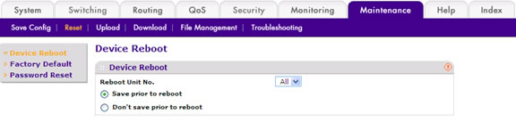

  1. To use GUI to restart the switch, go to web page 'Maintenance->Reset' page, Device Reboot table.
Make sure that "All" is selected in 'Reboot Unit No' drop down menu box. If it is shown with some other value like '1', then only unit 1 in the stack will be rebooted, and this may result in stack failure after the stack is rebooted. You may select 'Save prior to reboot' option if you feel there are changes that may not have being saved. Click 'APPLY' button to start the reboot process.
