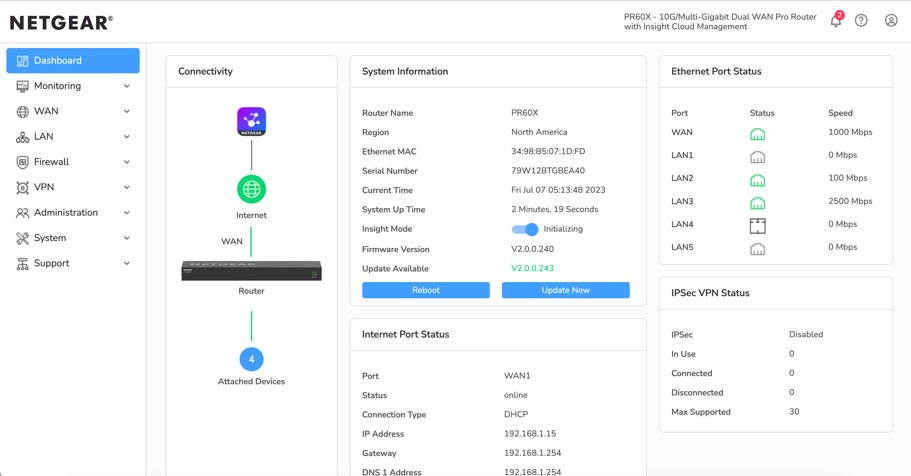

  5. Click the LOGIN button.The Dashboard page displays.
  6. Select Administration > Firmware Update.

    The firmware version displays on the Dashboard page.

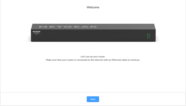

Let the Router Automatically Update the Firmware During Initial setup
  1. Launch a web browser from a computer that is connected to a PR60X LAN port.
  2. Enter the IP address that is assigned to the Router. If client is directly connected to the routers LAN network, you can enter https://www.routerlogin.net. Otherwise, enter https://<IP-address-of-Router>.
    Note: If the IP address of the router is its 192.168.1.1 default address, enter https://192.168.1.1.
    A login page displays.
    If your browser displays a security warning, you can proceed, or add an exception
    for the security warning. For more information, see https://kb.netgear.com/000062980.
  3. Enter password as the router login password (also stated on the router label) and click the LOGIN button. The password is case-sensitive.
    The Welcome page displays.

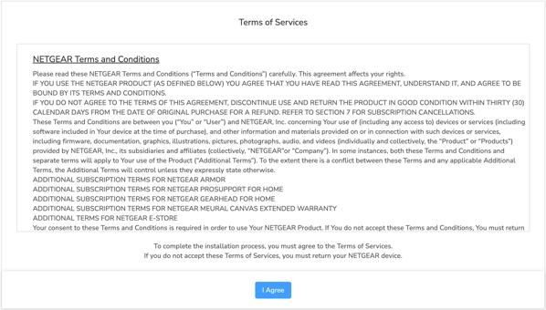

  5. On the Terms of Services page, click the I Agree button.

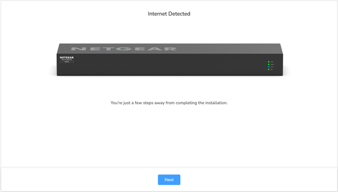

  6. On the Internet Detected page, click the Next button.

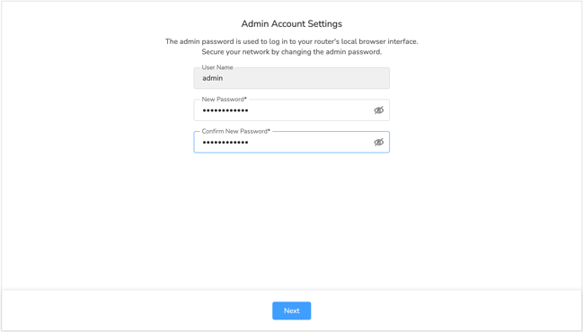

  7. On the Admin Account Settings page, set a new router login password, and click the Next button.

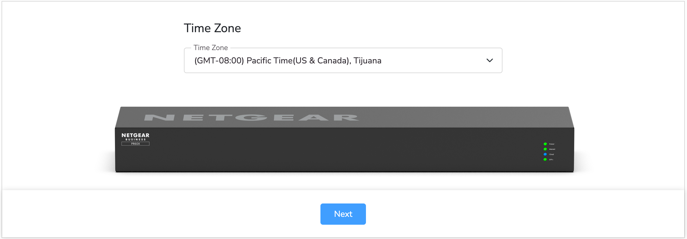

  8. On the Time Zone page, select your time zone, and click the Next button.

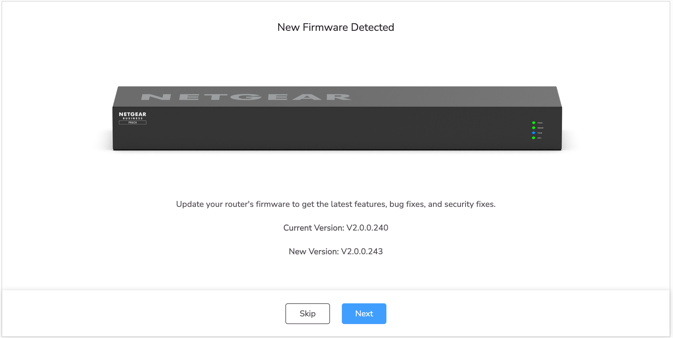

  9. If the New Firmware Detected page displays, click the Next button.
    A pop-up window displays.
  10. In the pop-up window, click the Update button.
  11. Wait for the upgrade to complete.
  12. In the Firmware update complete pop-up window, click the OK button.
  5. In the System Information pane, click the Update Now button.
