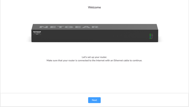

    The Welcome page displays.
  4. Click the Next button.

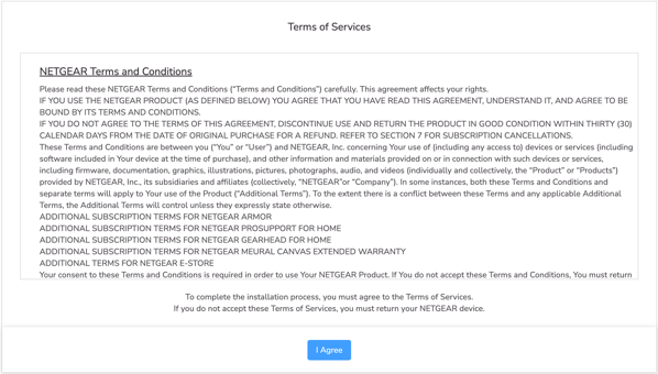

  5. On the Terms of Services page, click the I Agree button.

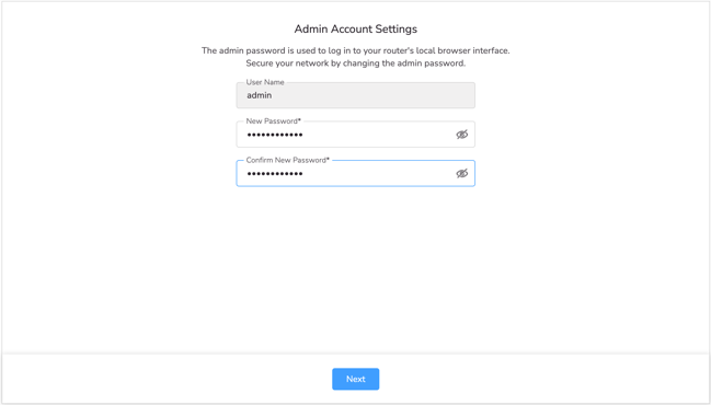

  7. On the Admin Account Settings page, set a new router login password, and click the Next button.

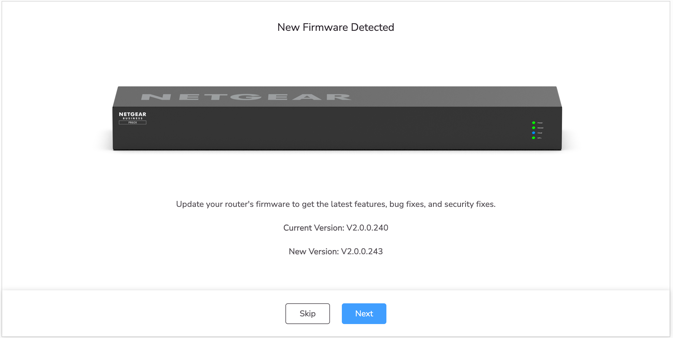

  9. If the New Firmware Detected page displays, click the Next button.
    A pop-up window displays.
  10. In the pop-up window, click the Update button.
  11. Wait for the upgrade to complete.
  12. In the Firmware update complete pop-up window, click the OK button.
  13. When the update is finished, log back into the router.
    The firmware version displays on the Dashboard page.
