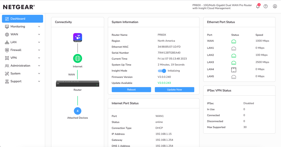

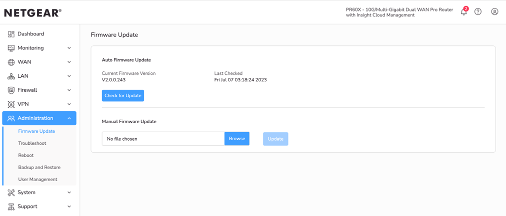

  6. Select Administration > Firmware Update
  7. Locate and select the firmware file on your computer by doing the following:
    1. In the Firmware Update section, click the Browse button.
    2. Navigate to the firmware file.
      The file name ends in .bin.
    3. Select the firmware file
  8. Click the Update button.
    A Firmware update confirmation pop-up window displays.
  9. Click the Update button.
    The page displays the update progress. The update takes about 90 seconds.
    WARNING: To avoid the risk of corrupting the firmware, do not interrupt the update. For example, do not close the browser, click a link, or load a new page. Do not turn off the router. Wait until the router finishes.
  10. When the update is finished, log back into the router.
    The firmware version displays on the Dashboard page.

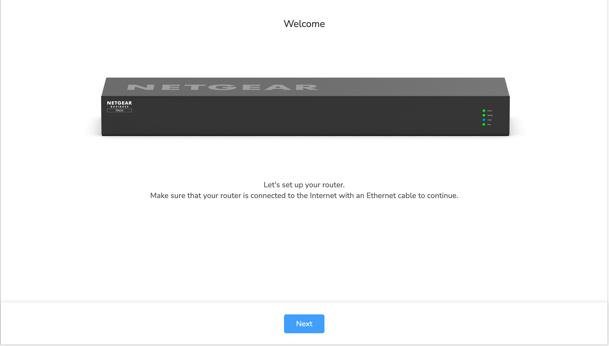

    The Welcome page displays.
  4. Click the Next button.

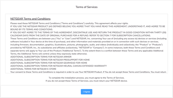

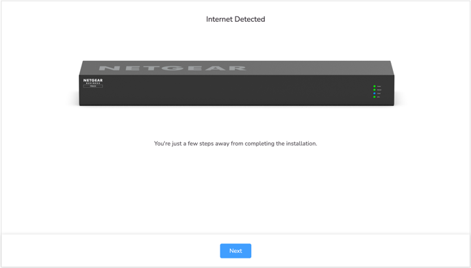

  5. On the Terms of Services page, click the I Agree button.
  6. On the Internet Detected page, click the Next button.

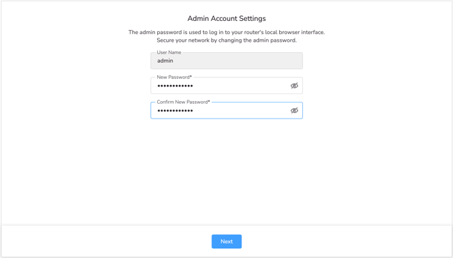

  7. On the Admin Account Settings page, set a new router login password, and click the Next button.

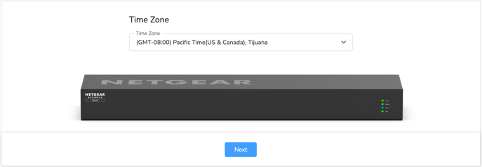

  8. On the Time Zone page, select your time zone, and click the Next button.

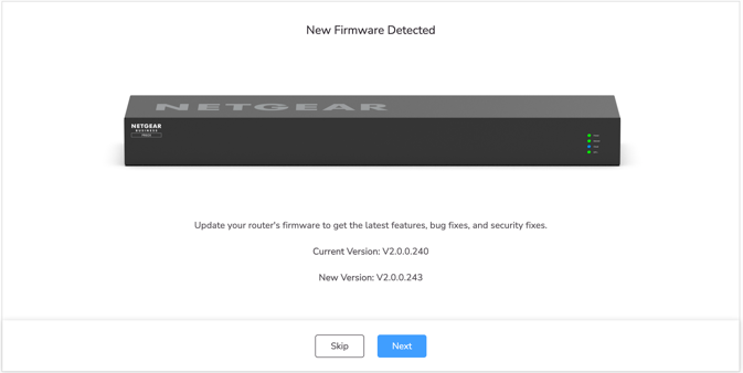

  9. If the New Firmware Detected page displays, click the Next button.
    A pop-up window displays.
  10. In the pop-up window, click the Update button.
  11. Wait for the upgrade to complete.
  12. In the Firmware update complete pop-up window, click the OK button.

  5. In the System Information pane, click the Update Now button.
  6. Click the Update button.
    The router locates and downloads the firmware and begins the update. The page displays the update progress. The update takes about 90 seconds.
  7. When the update is finished, log back into the router.
