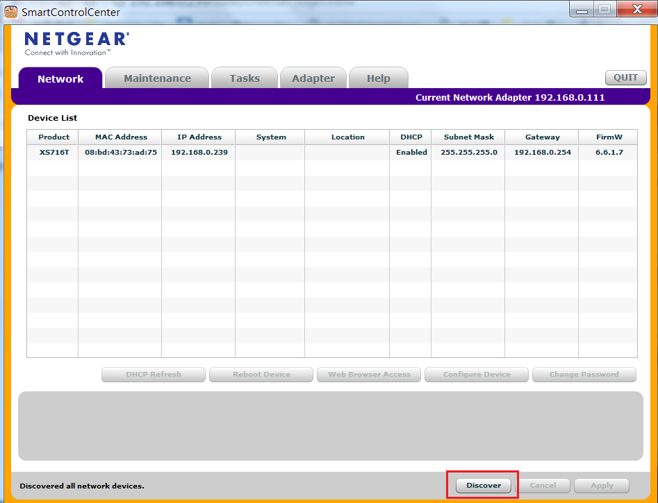

  6. On the SCC tool, click the Discover button.

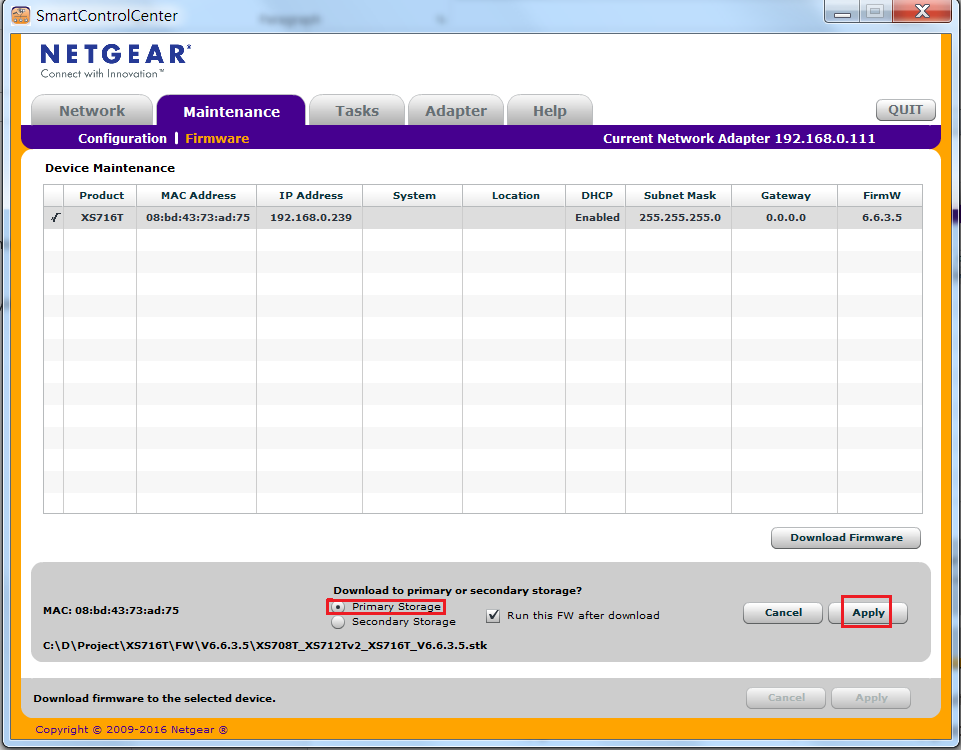

  9. Click the Download Firmware button, and select the v7.0.0.20 firmware file. The file name should be xs7xxtv7.0.0.20.stk, which is unzipped from the firmware release zip.
  10. Select the Primary Storage radio button and the Run this FW after download check box, then click the Apply button.

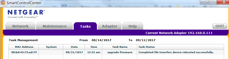

  13. You can check the firmware update progress on the SCC tool in the Task tab.When the firmware update is complete, you should see “Complete file transfer; device rebooted successfully” message on the SCC tool.
