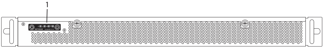

Before accessing the boot menu, refer to the images below to become familiar with the buttons and LEDs on your system.
  1. Control panel.
The following image shows the control panel in more detail.
  1. Reset button.
  2. LAN LED
  3. Health LED
  4. UID LED
  5. Power LED
  6. Power Button
