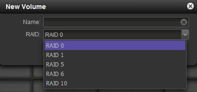

3. Below the enclosure, click New Volume.
The New Volume pop-up screen displays:
The RAID levels that are displayed depend on the number of disks that you selected.
4. Configure the following settings:
  • Name. Enter a name for the volume. The volume name must begin with a letter, and can contain only alphanumeric characters, underscores (_), hyphens (-), periods (.), and colons (:). The volume names mirror, logs, and spare are reserved and cannot be used, as are all names that begin with the c[0-9] pattern. However, you can use names that begin with the C[a-z0-9] or c[a-z] pattern.
  • RAID. From the drop-down list, select the RAID level. The RAID level that you can select depends on the number of disks that you selected in Step 2. For more information on RAID levels, see the What is RAID and how does it work with my ReadyDATA storage system?

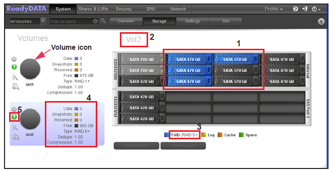

6. To the left of the enclosure, click the new volume and note the following:
  • The color of the selected disks in the enclosure turns blue (1).
  • The name of the new volume displays above the enclosure (2).
  • The selected RAID level for the new volume displays below the enclosure (3).
  • Information about the new volume displays to the left of the enclosure (4).
  • The virtual LED indicates the health status of the volume (5).
